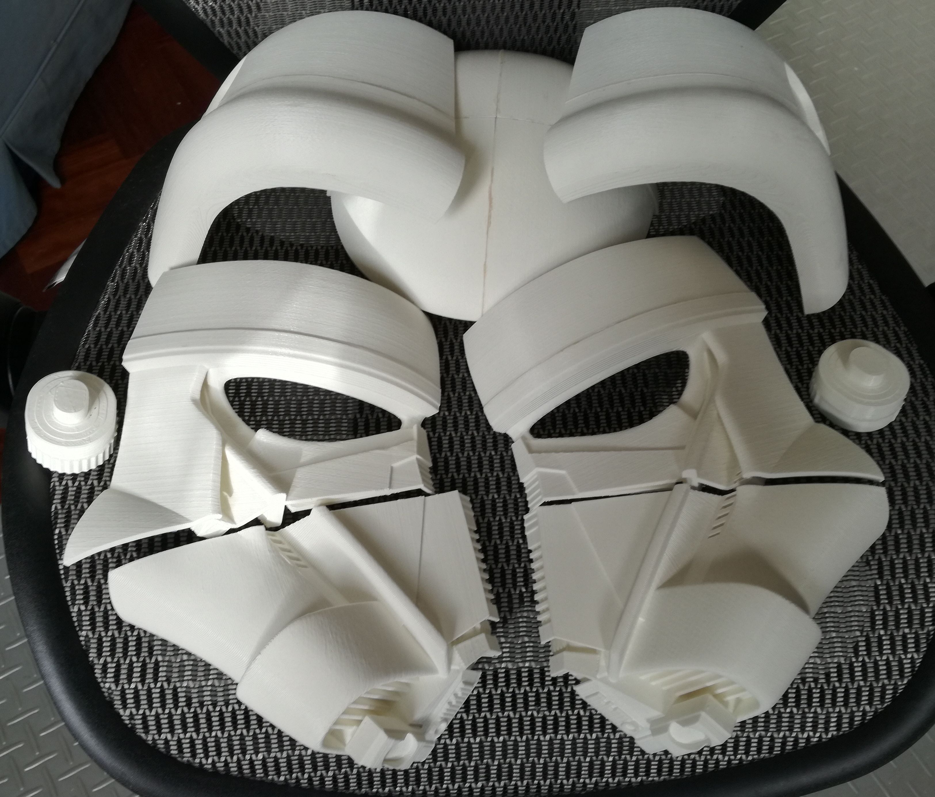

Hi,
I decided to post this print as this probably is the largest and longest series of prints I probably did with my UMO.
I have already glued together some pieces and I will need to continue the gluing process as well as the sanding one.
Will try to keep this post updated aswell with the post processing of this print :)
In the meantime, here's how it looks so far :)
This was printed in white PLA at 0.3 with 40% cubic infill and 1.2 walls.
Next steps:
1- Sanding of pieces
2- Glueing of pieces
3- Sanding of whole
4- Coating with XTC-3D
5- Sanding of whole
6- 3 coatings of black primer
7- Painting (to be reviewed)
8- Green Leds circuitry?
