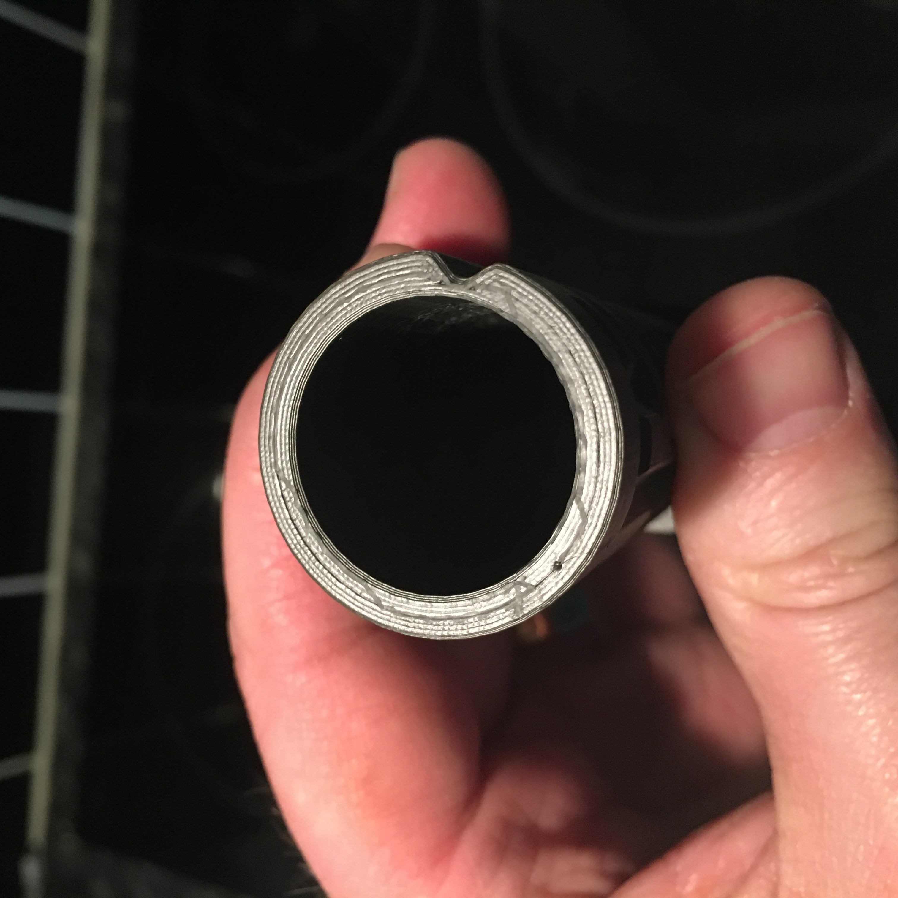

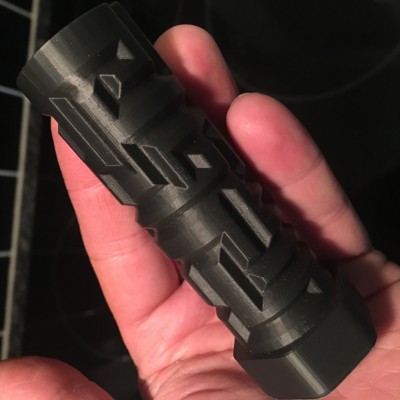

Printed the base for the Labyrinth box in black Greentec. With filament set to 2.85 I need to increase flow to 1.10 because my spool is 2.73-2.75 in diameter.
0.15 layers, 40mm/s, 220C sliced with S3D...only tiny tiny blobs can be seen.
It is also one of the first prints with the bed stabilizer in place. There is a noticeable improvement in surface quality
Printing the lid in blue Greentec right now. That spool seems to be slightly better...2.80 in diameter.

Re: Extrudr PLA Tec Black
In S3D , are you using Coast at End? I still love the quality of prints I get but get that occasional blob too
Nice print
Nice print
Yes, it's enabled and set to 1.00mm. They are almost invisible...but increasing that setting does not improve the blobs. For now I'm satisfied, until I have the #gudoZGE up and running with all the flexible parts in place. That's when tuning 2.0 starts
