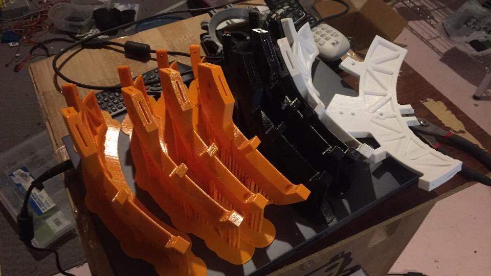

With some settings tune up, is quite easy...
Ofc, it takes time and material to learn.
https://twitter.com/neotko/status/849298464018227200
