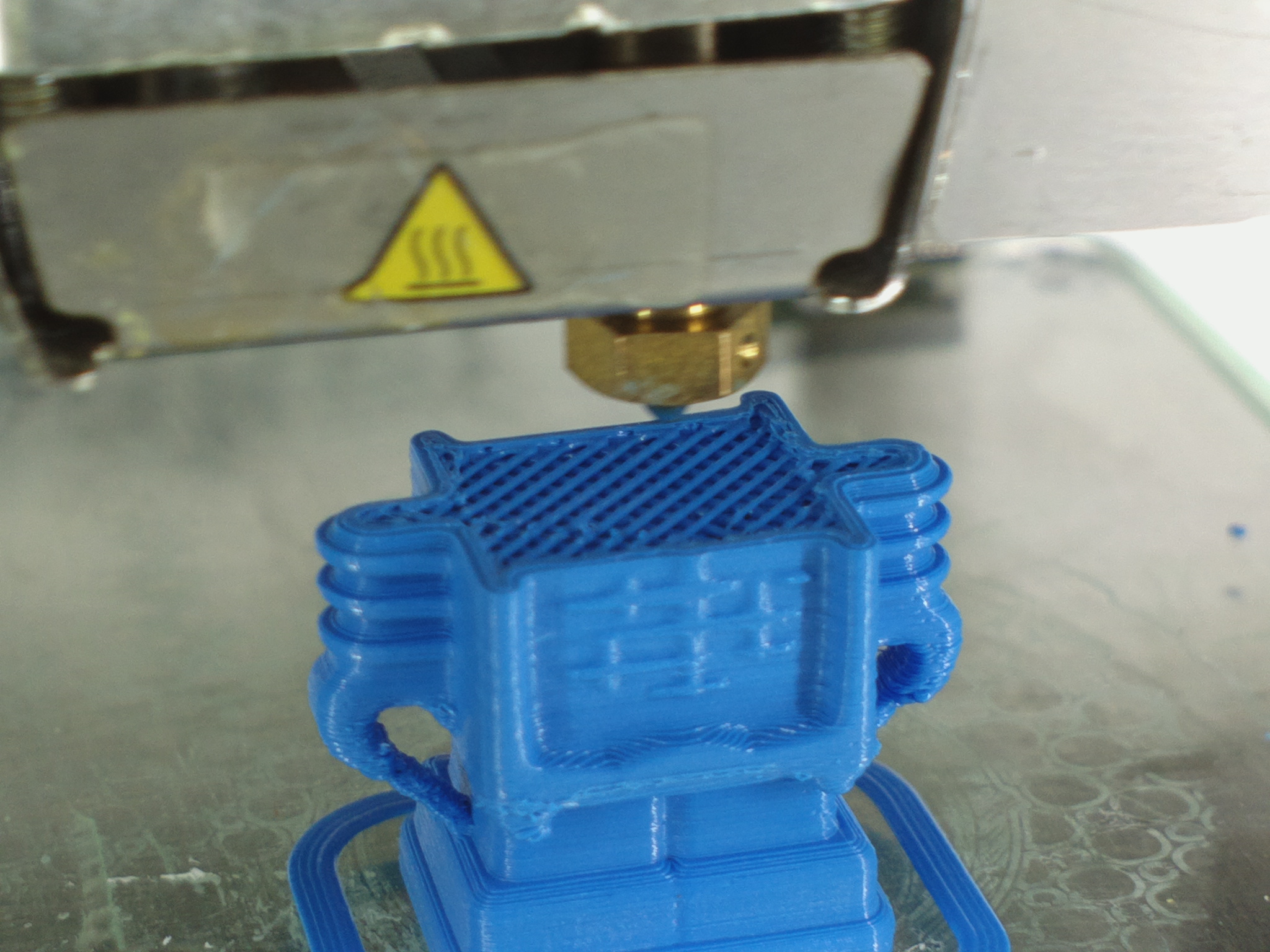

Re: Cura Feature request: Infill Height
And that was on a 20x20 test cube.
Imagine the time you save on bigger prints, without having to sacrifice the outer finish/look!
