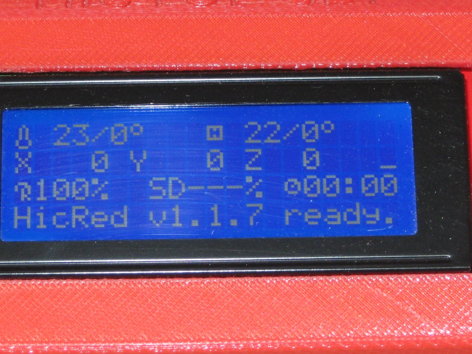

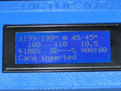

Today I dove into Marlin 1.1.7. appears to function (meaning it prints ok)
However symbols on the display keep changing and are strange.
The degrees symbol changes into the top half of the "H" Heat-bed symbol
The Flow Rate has 4 different symbols including one that looks looks a (circle with a line pointed to 1)

I noticed on Marlin 1.1.7 the After the Z-Height there is a blinking cursor, this may be the problem.
You can see the cursor in the above picture with the Red LCD Controller case.
Finally flashed to Marlin 1.1.9, the display works correctly again finally.
