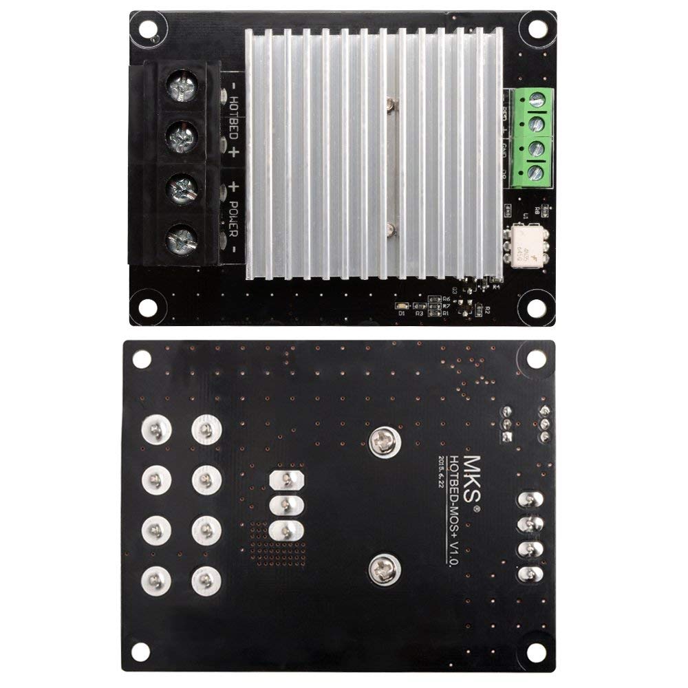

I bought a Mosfet
I have wired it up, I think correctly as it seems very simple, I set the temp of the bed to say 60°C and nothing happens, it does not get hot.
I am not an electrician so I am limited to what I can do.
I have checked the voltage that goes into the Mosfet and it's 12v, so that bit is OK.
The output is zero.
I have tried switching around the wires that come from the MKS board but that make no difference.
I think the Mosfet is not working.
I took out the Mosfet and I re-connected the old wiring and it works OK.
The reason I wanted to upgrade is because I sometimes get Themal runway error, reset when heating the bed.
Any advice would be useful.

I looked at the link and also watched the video. It appears I did wire the Mosfet up correctly!
So it must be faulty.
