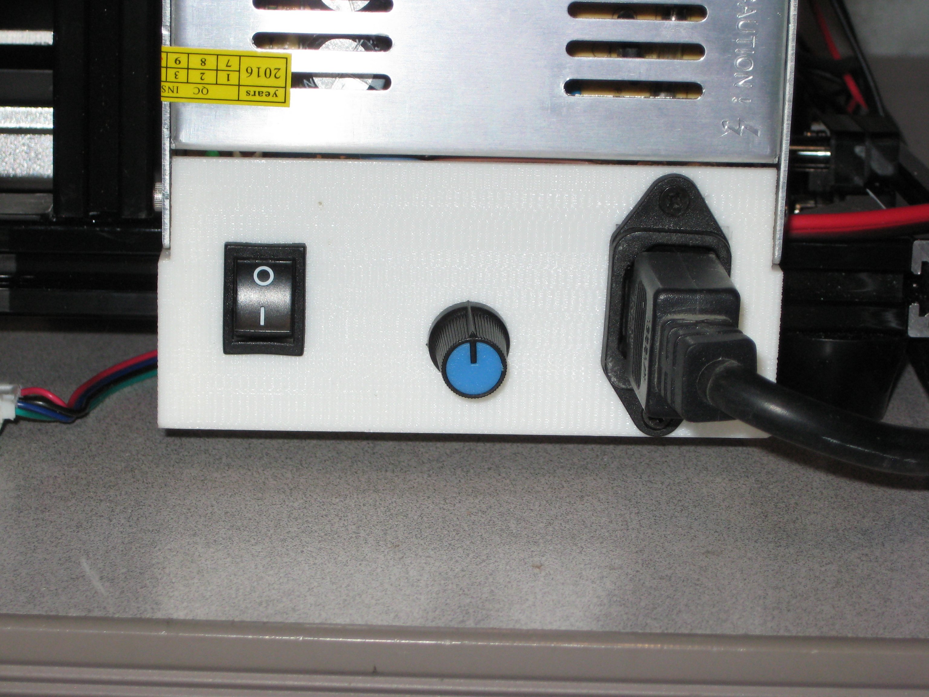

Powered on my Hictop 3DP12 - 24volt 3D Printer the day before Christmas and blew the power supply,
Sparks were flying out threw the 3D Printed Supply cover, as there is a vent hole in the bottom.
Thought would make a video of how to repair a Switching supply.
Did a quick diagnostic to see if it was worth repairing, parts cost grew to more than a replacement supply.
Replaced with the Backup S-480-24 supply had purchased for the 12V 30A 360watt supply on 3DP11.
Supply on order will be here by Dec 31

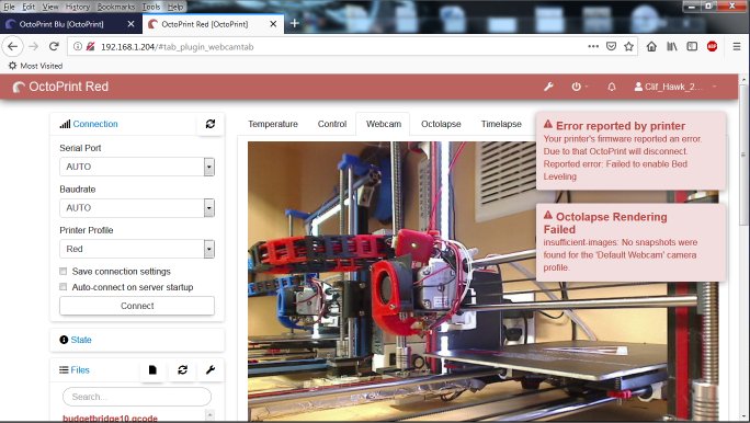

It appears that sense updating to Marlin 2.0.0 when I try to use the octolapse plugin I get a failure
Any Help would be welcome

Never Mind jumped the gun, Somehow I lost the Bed leveling Data as soon as I hit post and viewed to post I saw the Error.
Error reported by printer
Your printers firmware reported an error ;; This is where for some reason I must have stopped reading.
Due to that Octoprint will disconnect.
Reported error: Failed to enable Bed Leveling. ;; I never seen the line for some reason!!!
Whewww! sure am glad didn't flash the older Marlin 1.1.9BF
This has to be the first time I have seen the Auto Bed Leveling data fail to restore Bed Leveling Data...

Re: OctoLapse Plugin for OctoPrint
They probably changed the memory map location with the firmware update. Happens, even on a PC, which is why it is recommended to restore factory defaults and then change your settings when you update the BIOS in your PC (although some newer systems will store your settings before blasting away, then restore them).
