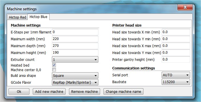

Cura 15.04.6 3D Printer setup.

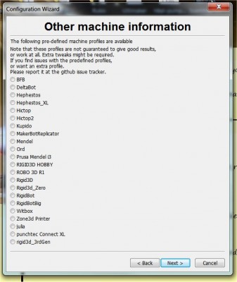

How do you get those printers to show up or add? I don't see anything pertaining to a Hictop.

OK!
I created the Hictop Profile using the following steps.
Cura 15.04.6 Run Program
Click On Machine, Select Add new machine then select next.
Select Other from Select you Machine.
Image Below
As you can see my Cura Has Hictop, This is because I added it to the list.
I went into the "Cura_15.04.6\resources\machine_profiles folder" and created a simple Hictop Profile.
One of these days maybe I will create a better more complex profile.
Hictop.ini
(429 Bytes) Downloaded 1061 times
You can download this profile and add it to your "Cura_15.04.6\resources\machine_profiles folder"
Or you can use Prusa Mendel i3 and change to the to similar settings on the Image in my previous post..
