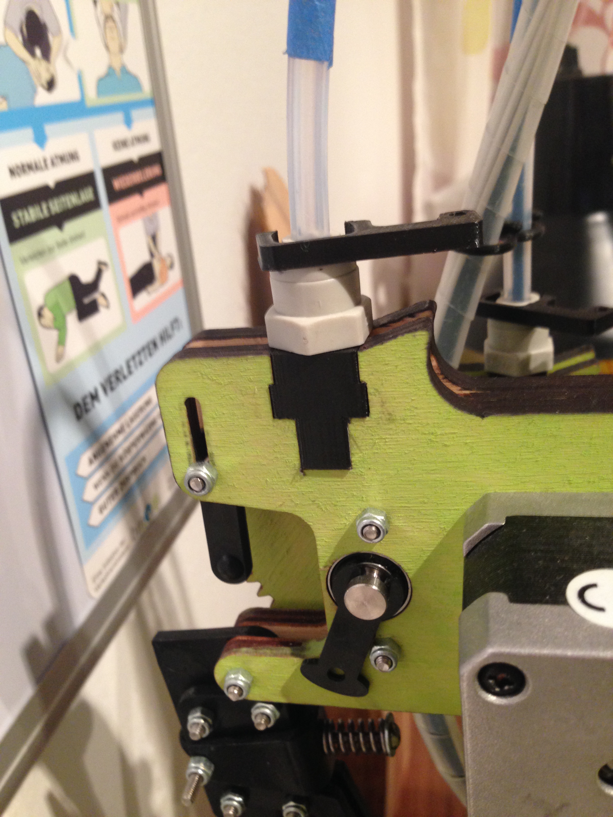

@ LePaul - had the same issue so I first checked if I mounted the bowden the corect way (one end is widened). that worked fine but lately I modified/printed this part to make the entry more straight: http://www.thingiverse.com/thing:1178679

Sorry, my fault... I had pictures there but not posted them...
Basically remove the grey bowden coupler at the feeder (I got mine out without disassambling...)
Screw this grey bowden coupler into the printed one (the black T-Nut at the picture) and push it in place into the ply.
Holds rock solid and has a tight fit internal diameter

Updated thingiverse too...
