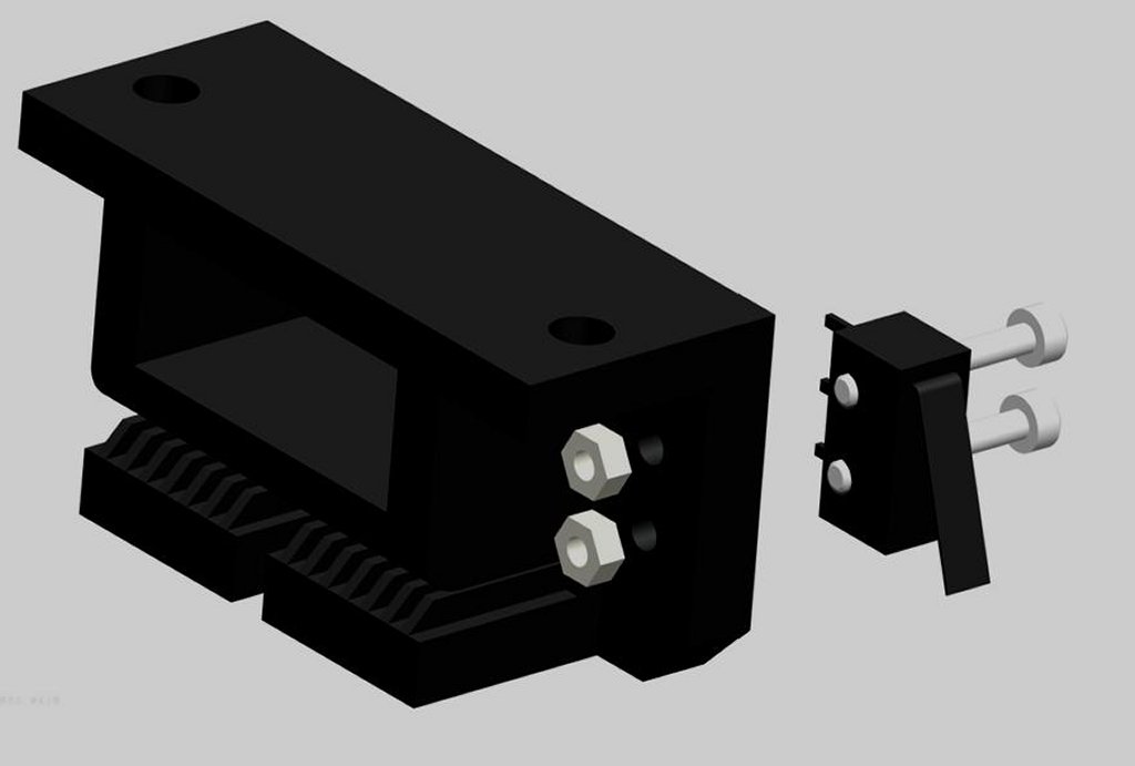

Step 14 : will show a 'sensor' for the Y-axis. It is one of the micro-switches (end-stop switches) in the plastic bag. You will have to separate the leads as they are shipped together. Install the switch along with wires as shown in diagram. NOTE: I had wires that came off the end-stop switches and found the factory solder job was horrible. SAVE SOME TIME and re-solder all end-stop switches before installation to save to headaches later on. OF NOTE: on ALL those small 2mm (and other screws) insure you use some type of thread locking compound on those nuts, they will come loose from vibrations and your switch will fall off = not good because your stepper motor will crash the axis into the hard stop and burn up the motor or control board if you are not there when it happens. Again - trust me.
Step 14 : Y-axis end stop switch mounting
