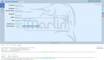

Installing the new firmware from Marlin Auto Build, what example do I choose? What changes do I need to make to the configuration files?

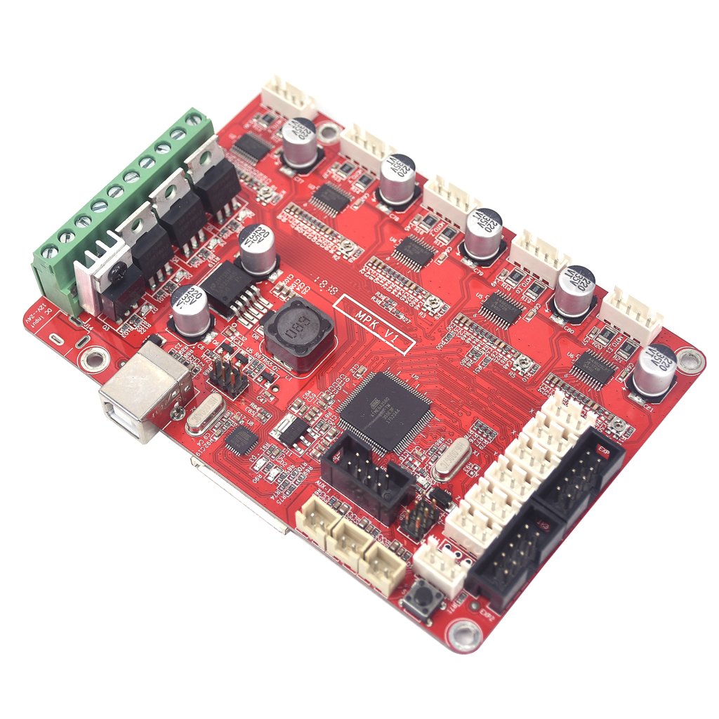

The controller you are using motherborad is "#define MOTHERBOARD BOARD_MKS_BASE_14 // (' EFBF ') to use 2nd Heater as 2nd Fan control"
Though it can use the a single extruder option of "#define MOTHERBOARD BOARD_RAMPS_14_EFB" or "#define MOTHERBOARD BOARD_RAMPS_13_EFB"
But I wouldn't you can it will work correctly with single extruder,
However I use this as "(' EFBF ') use 2nd Heater/2nd Fan or drive signal for Laser."
I also have lead screw configuration as
You original lead screw should be an all thread whereas I use a 2mm pitch lead screw vs your 1.25mm leadscres.

Whow! You are full of info!
Taking it slowly here, want to get it mostly right the first time.
I printed out the original configuration_H and adv files from the version from Hictop 2555 and your "Red Version". Went thru the 2555 active code lines and compared them to your red version.
Noticed the different in the default Steps per unit, will need to change those.
Really confused on all the LCD Display commands changes. I have the original LCD display.
Probably will need to comment out the filament out sensor.
The limit switch section has lots of changes.
I have the MPK V1, with only one extruder, so I think I should select #define MOTHERBOARD BOARD_RAMPS_14_EFB. Not really using the SD cards at this time, so unless they conflict with something, I can wait on those changes.
Have not completed the Configuration_adv_h file comparision. Will go back thru both again, will try to do a line number to line number difference on active code.

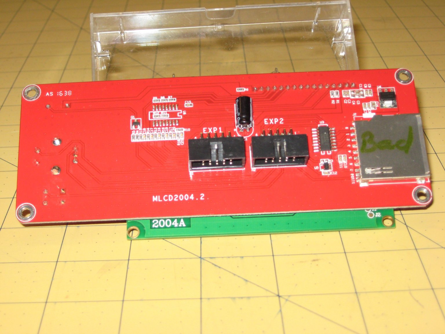

I just made a new "Marlin-2.0.6.1 with Visual Studio Code > PlatformIO > Marlin Auto Build" Look at this one.
This is the newest Marlin version I am currently configuring as compatible with Stock Hictop 3DP11 without Proximity Sensor.
I will verify this is as close as possible to Original Source, only this firmware is many times better than the original.
Well that went faster than I thought

// Your LCD Panel IS a LCD2004
#define REPRAP_DISCOUNT_SMART_CONTROLLER // CL: Stock HICi3 20x4 LCD controller
#define NEWPANEL
