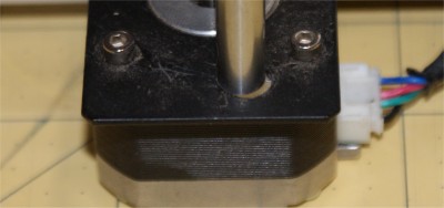

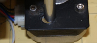

The First model will be printing is this Hic Tech 3DP11 Z axis solid rod fix.
To show you why this is so necessary viewing the images below, will be self evident.
For those of you who can not see the smooth rods wobble in the thin metal multi purpose stepper motor smooth rod holders.
This make for a really crocked Z-Axis on every model printed.

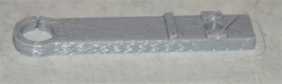

Attached STL FIle, the reason I created this is adjusting end-stop switch to hit the stepper doesn't work very well.
Hictop Y-Endstop stepper mount.stl
(424.79 KiB) Downloaded 531 times

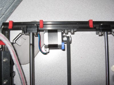

Dissembled the Hictop extruder assembly found the extruder gear set screws were catching on their 3D Printed exturder housing.
Reversed the Gear an printed again.
Still need to adjust the belt tension to get the best print results. just troubleshooting simple problems.

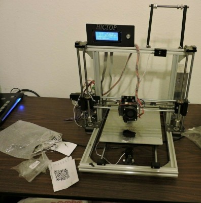

If you look at the image above you will see that a stock machine still has a lot of wobble, but prints a fairly good model.
After Cleaning all bearings the print improvement will be notices quite easily.
