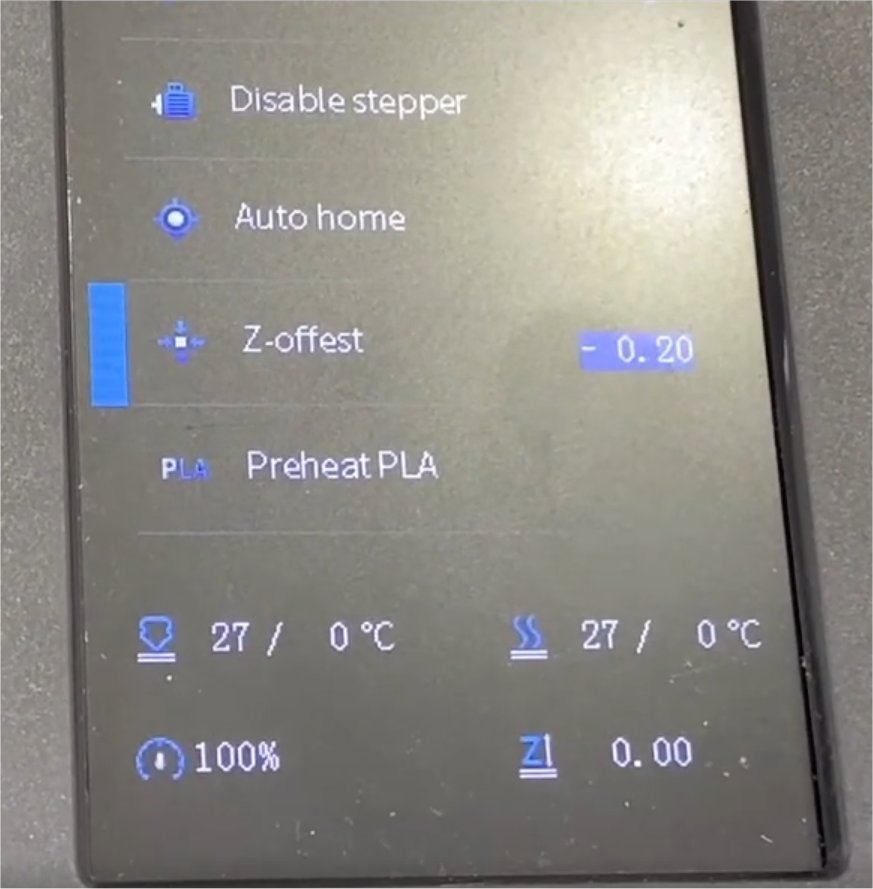

I was watching a Youtube video showing CR Touch.
In the video it showed I could adjust the Z-Offset live and save the offset image below simple set Offset click and nozzle moves to that height.
I do not know how to enable this menu help me.
