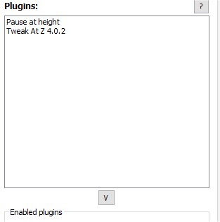

Re: Pause a print in Cura
Where To Find The Feature – Cura Pause at Height / Layer
An in an older version of Cura below
Cura 15.04.6.jpg (8.43 KiB) Viewed 24008 times

It's a script you add, no wonder I couldn't find it.
Thanks I'll give it a go.
