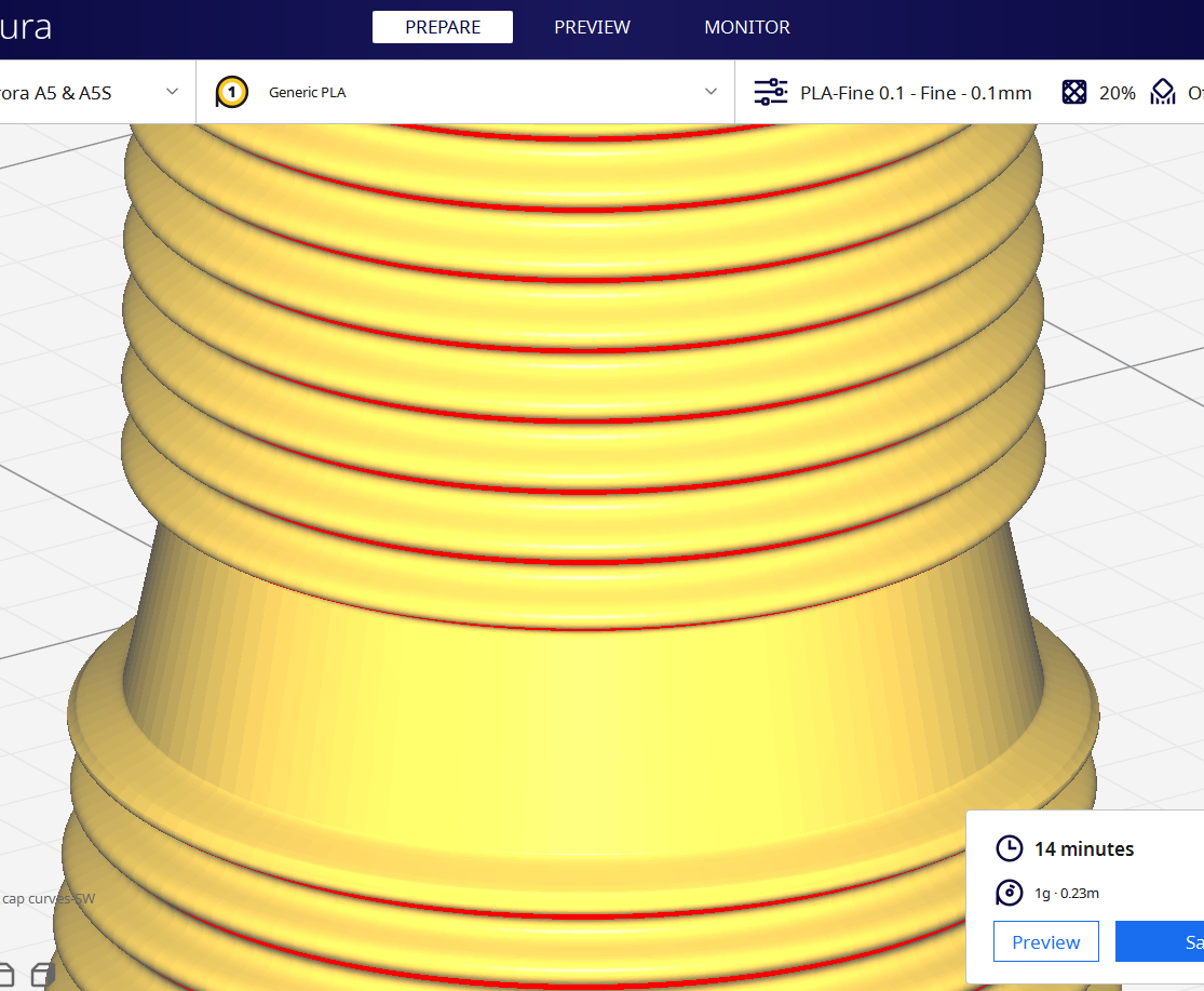

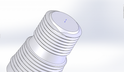

Well I have imported your stl file into Cura.
I also imported the step file into Solidworks then exported an stl file.
I then exported an stl file from FreeCad.
When I imported all of these files into Cura they looked good with very very small facets.
One thing I did notice when I imported the step file into Solidworks the Top didn't import correctly.
File in Cura
File in Solidwork:
How does it look in your slicer software.

That blemish does not appear in my slicer software.
Anyway, although I think I saw a recommendation that step format was the best export format for 3D printers, and there is probably a way to control the level of detail, it seems that .stl export for me gives a fine result. So far I have not actually printed from that version but since the first time the facets on the 3D print matched the screen image in the slicer program, and now that image is smooth, I expect it will be good.
