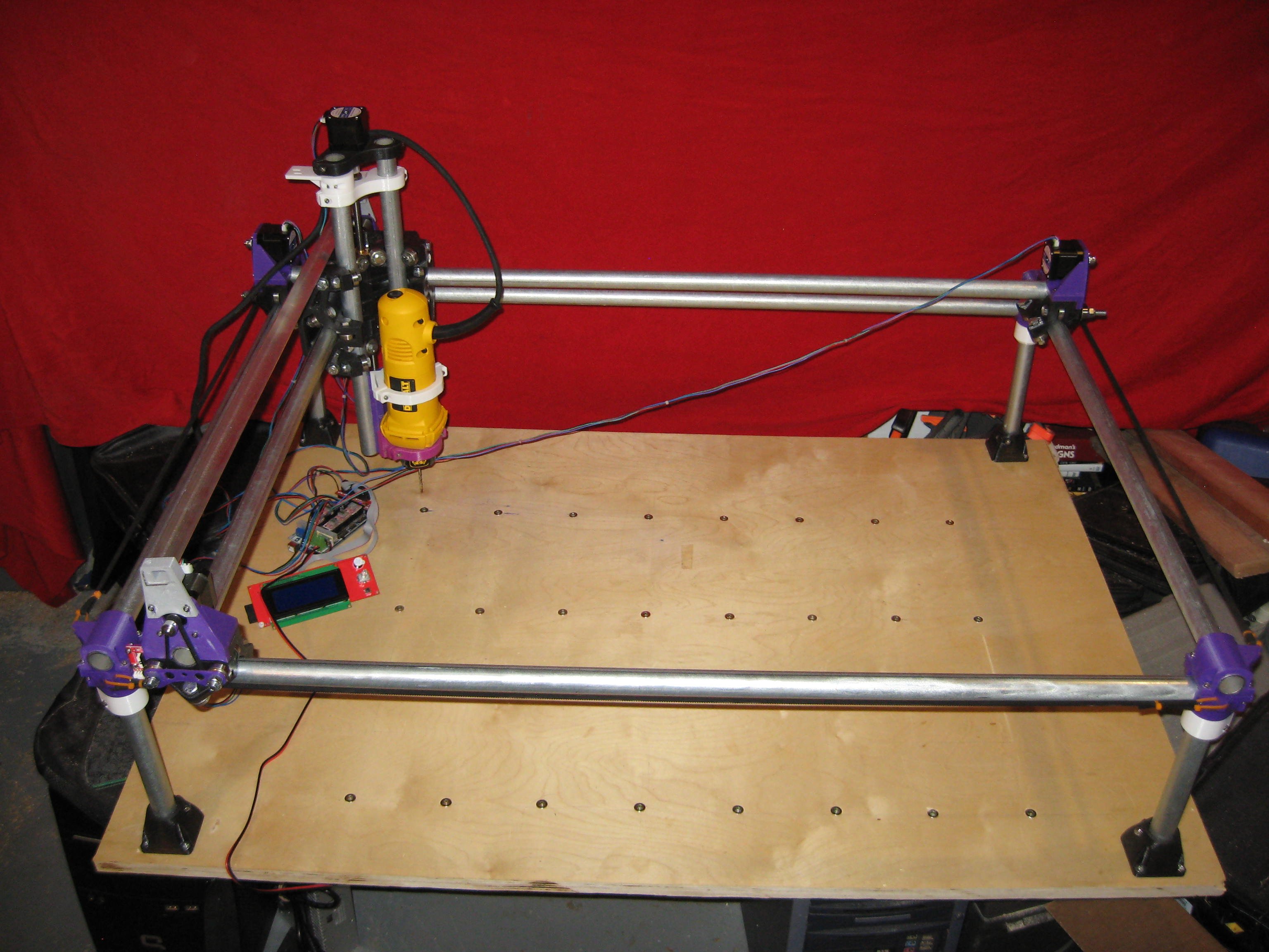

I built this simple Enclosure pictured below and believed that my 3DP11 and 3DP12 print ABS almost to perfection.

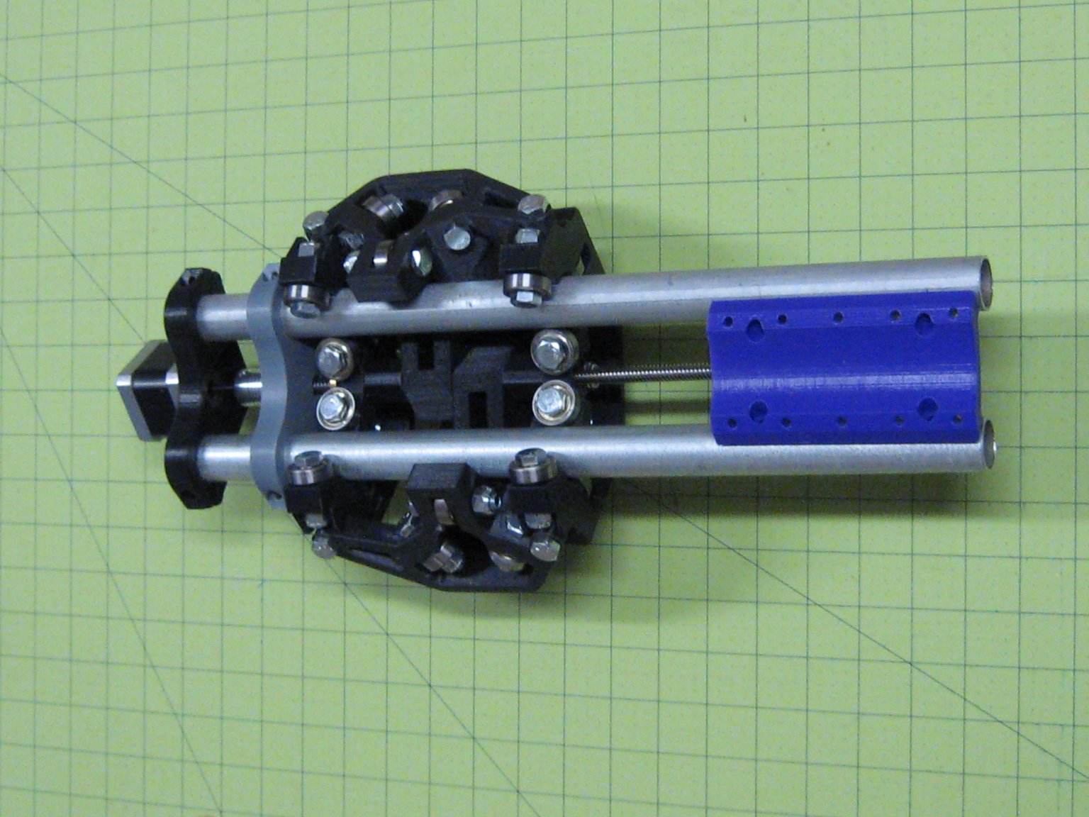

I 3D Printed in ABS most of the Parts for my MPCNC
Though I had problems with bed warping at temps above 96C I never had problems printing any model with the settings below

I have a few post on making this MYCNC posted on this forum simply search "MPCNC"
