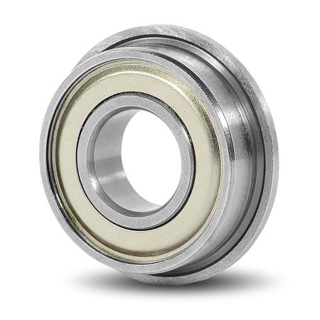

I Have a 3DP11 and 12
I also had troubles aligning the Y axis, Then I found these MF128ZZ 8 X 12 X 3.5 Flanged Bearings. They are half width bearings, the Belt will run between the Flanges of two placed with the Flanges facing outwards on the 8MM bolt. Now the belt never rubs the Y Axis frame, same Ideal as the X_Axis belt assembly.
Could not get my filament monitor to work tried every pin re-flashed every option everyone suggested, until I decided try to wire it into the unused X_Max pin and Connector and can't remember where I read it to thank them.
