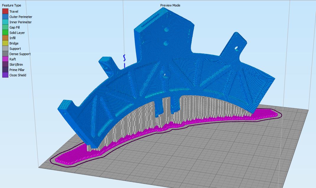

Default Ultimaker 2+ settings in S3D
Raft layer is so sloooooooow
Re: Why is this so slow?
Raft is a fixed thing on s3d. It creates a series of layers with very high Z extrusion to create an almost 1mm base to compensate for bed errors. Click on 'disable something first layers' and the speed and settings are more easy to adjust. But the way raft is made doesn't allow toom for much adjustments.

This print is tall
It has sped up considerably now. First time using this!

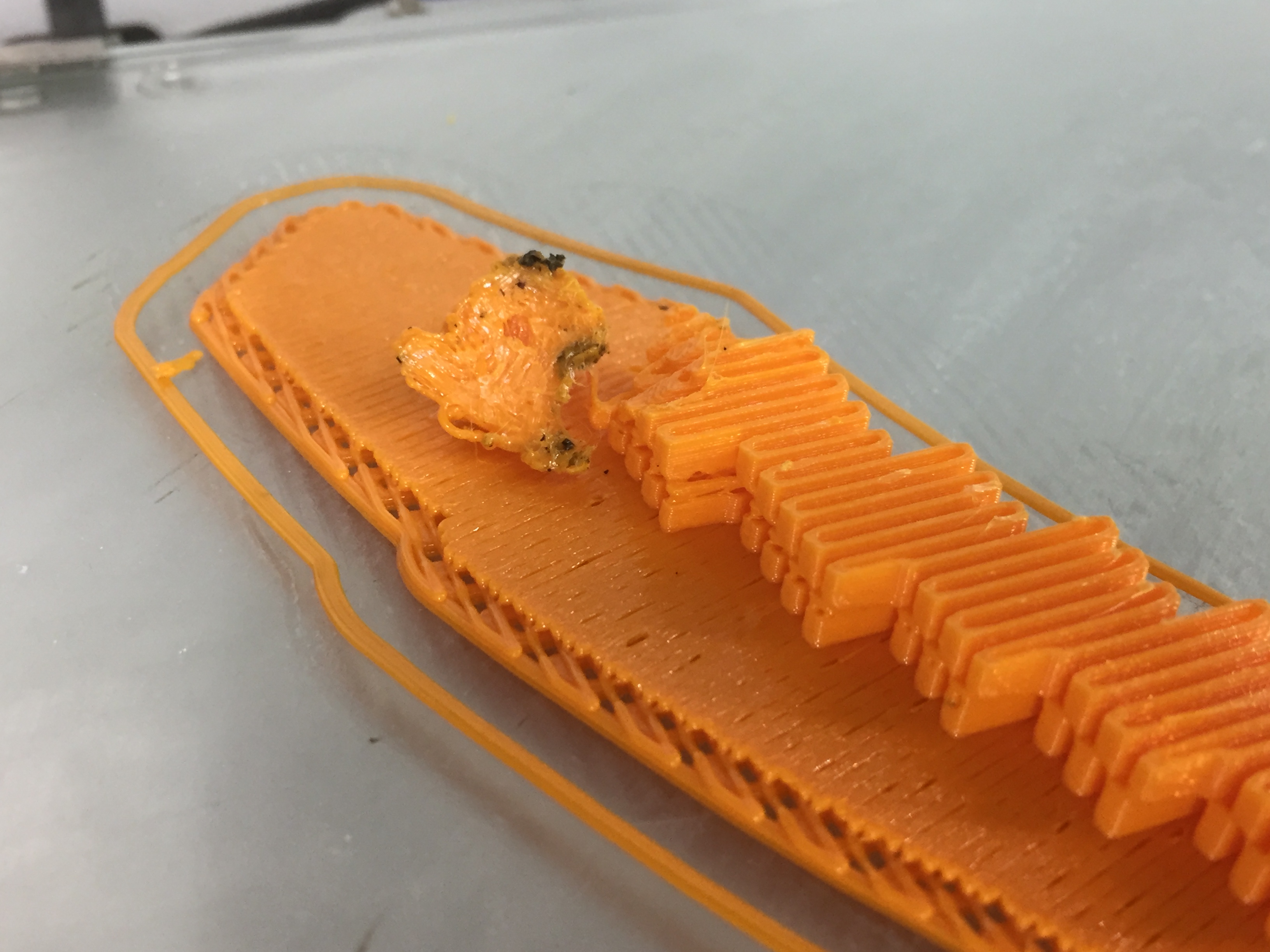

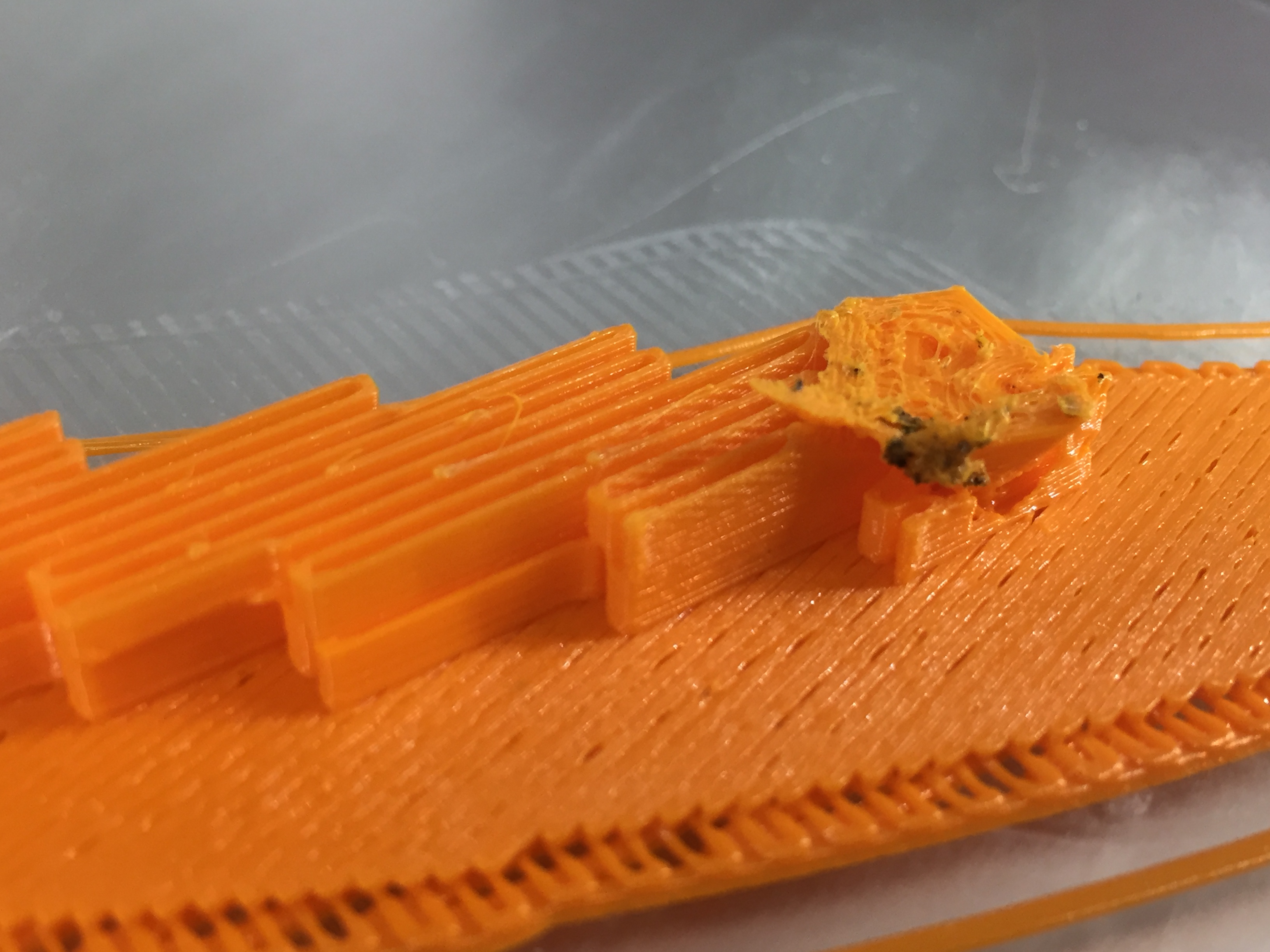

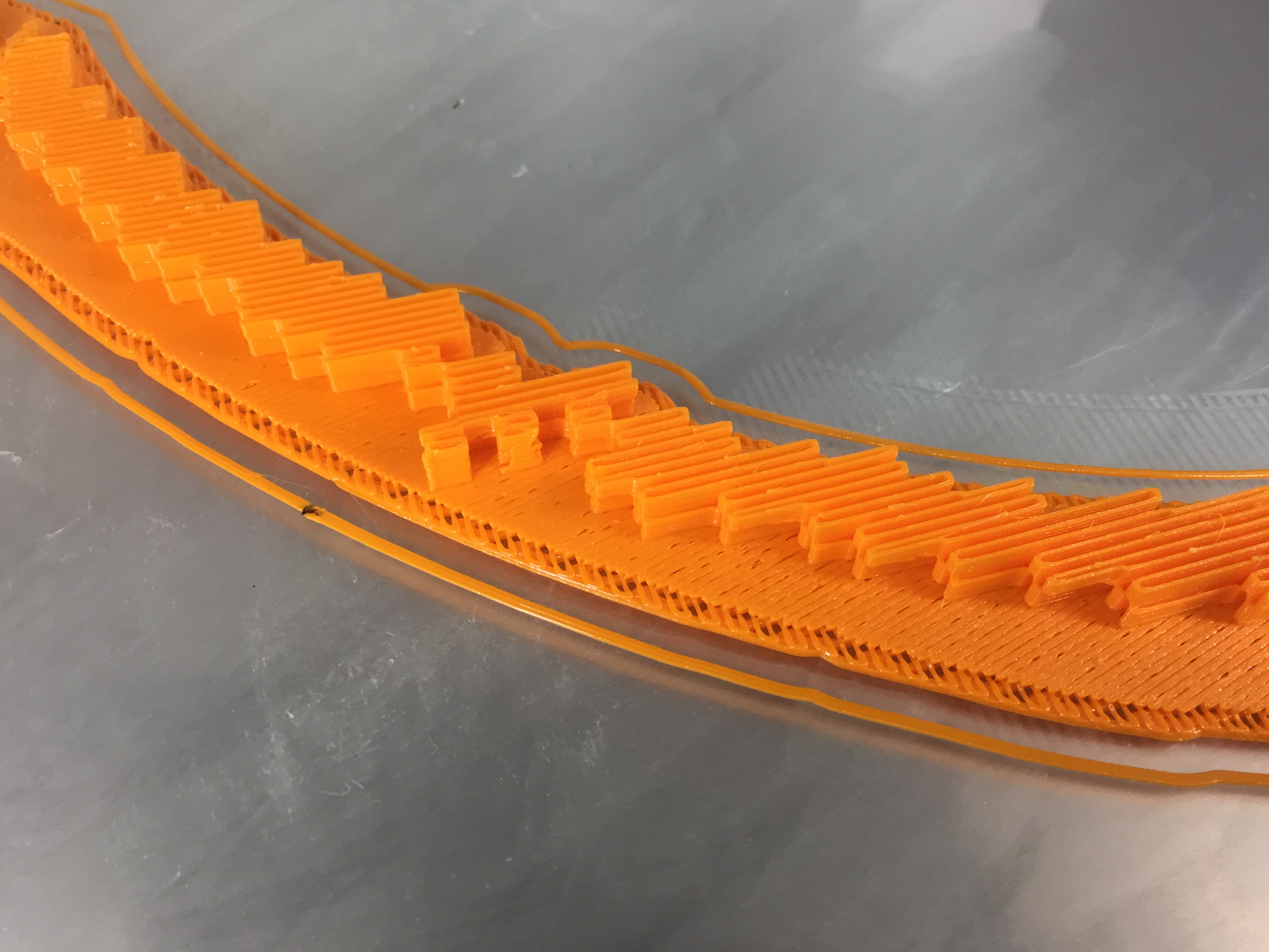

Failed badly

And Simplify clobbered my feeder

Or should I say....and clarify...giving it Cura retraction settings!

Simplify shouldn't be used with Cura's retraction settings.
I had the same issue also using Neotko's settings.
Do the following to check that the retraction settings are correct:
1- Install a filament dust filter before the feeder
2- Set the retraction amount
3- Verify that the printer is retracting the correct amount (you will see the dust filter moving back and forth and the distance between the filter and the feeder = retraction lenght)
With S3d if you enable the nozzle wipe and other stuff it does retract WAY MORE than then retraction lenght you set.
