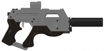

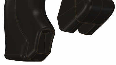

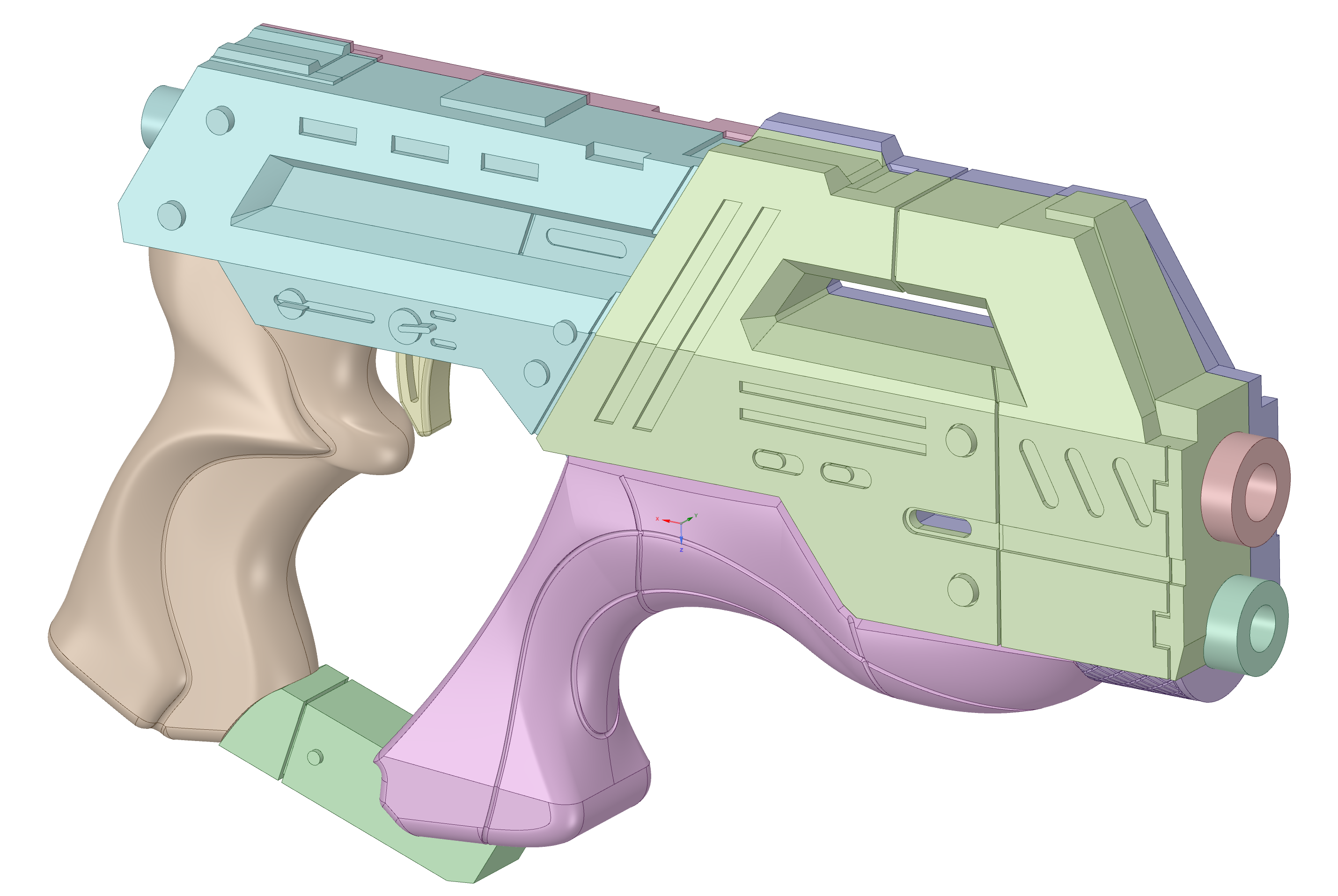

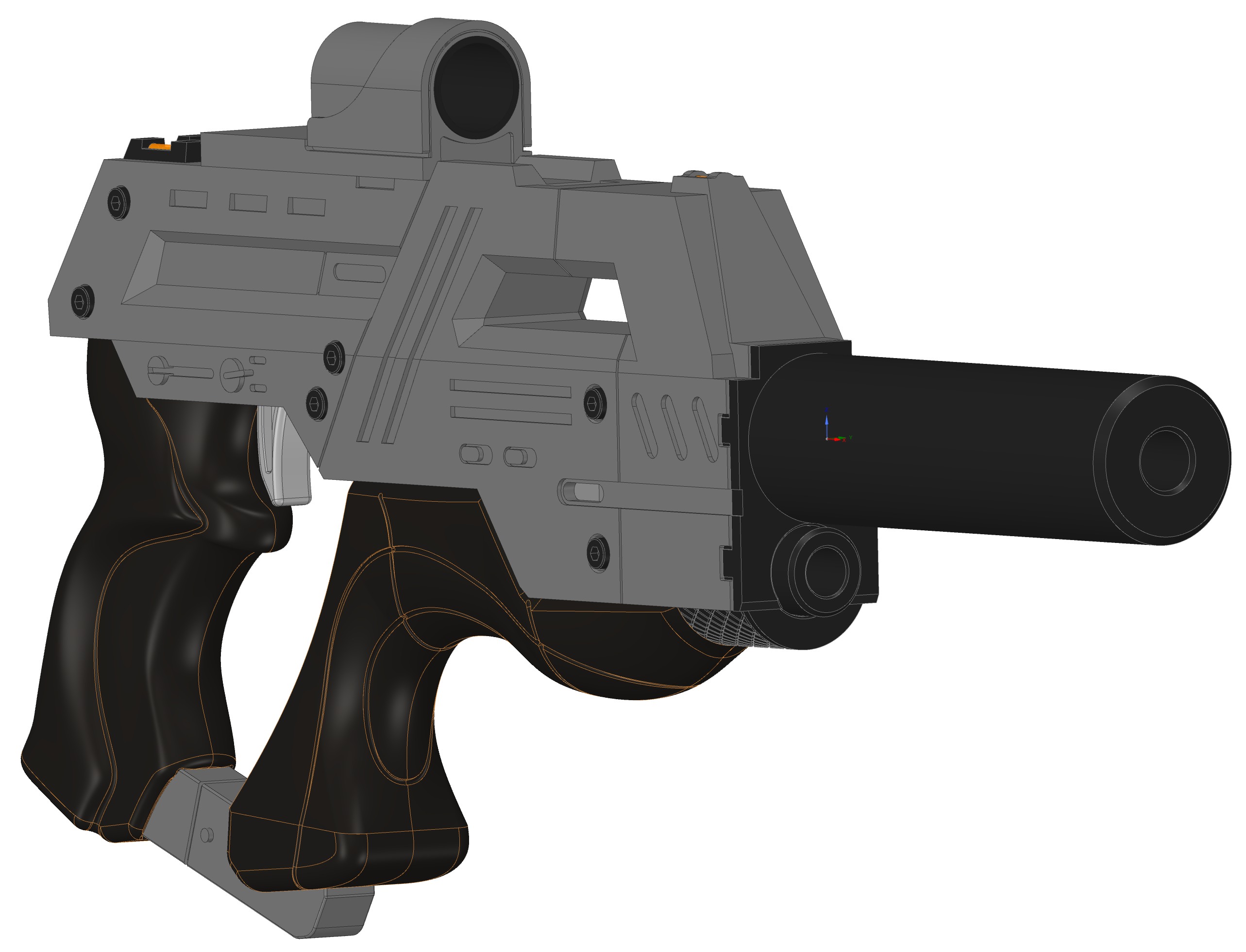

Jess' Carnifex design and my starting point. Colors are random. I know it looks off, sorry

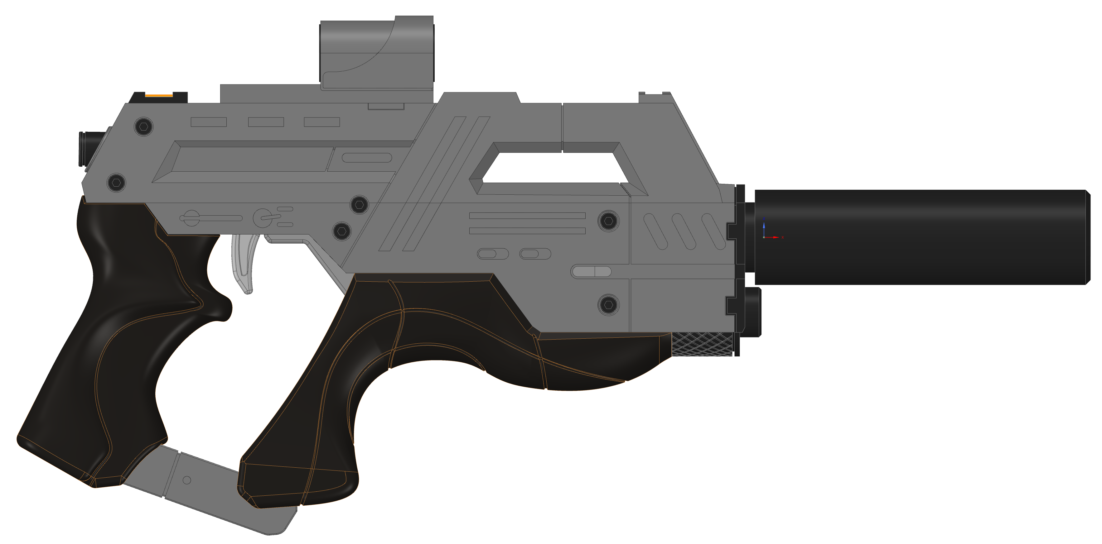

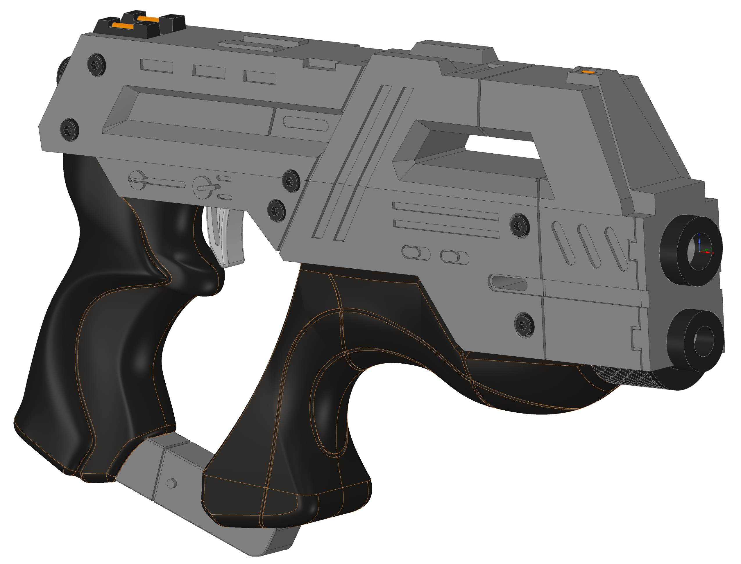

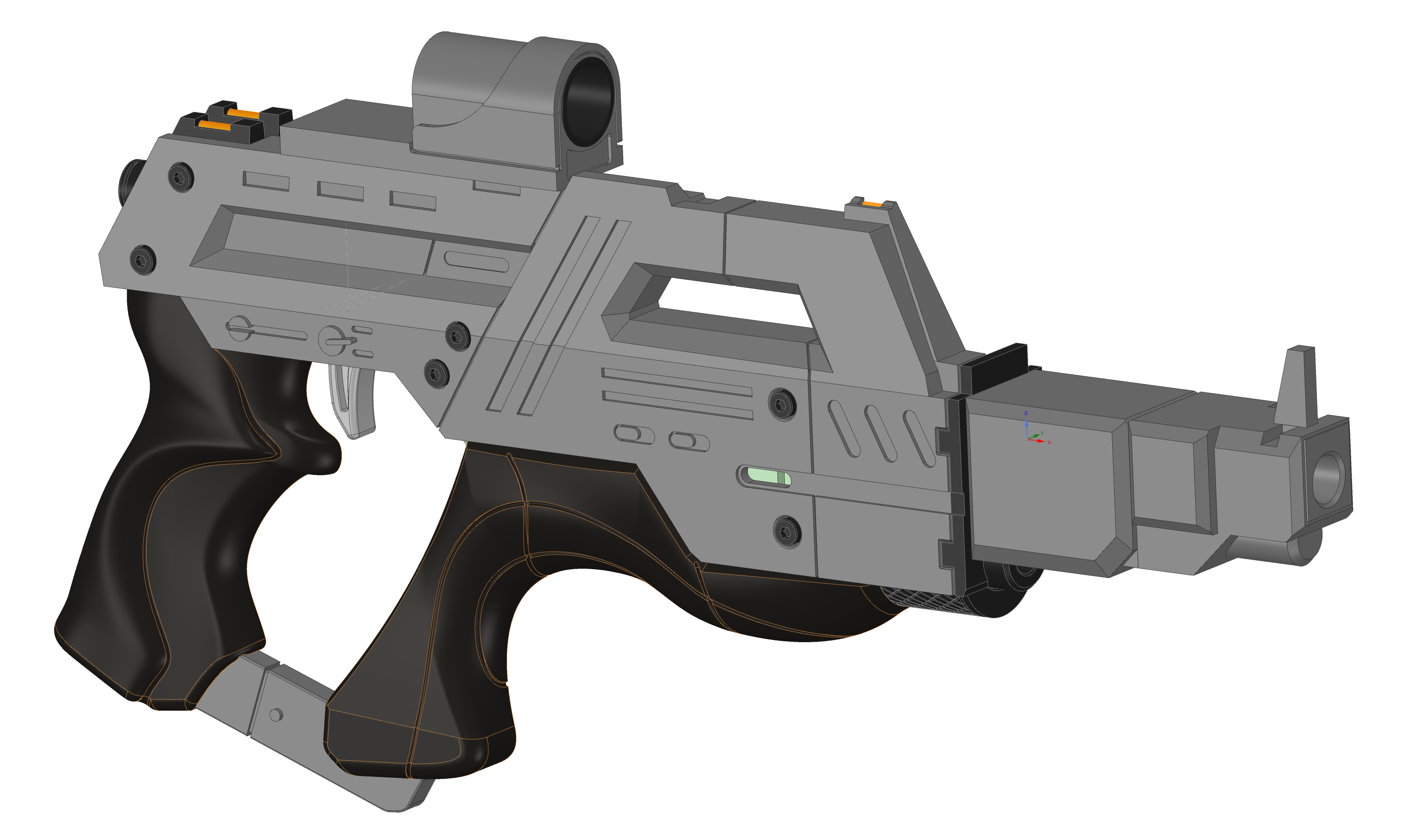

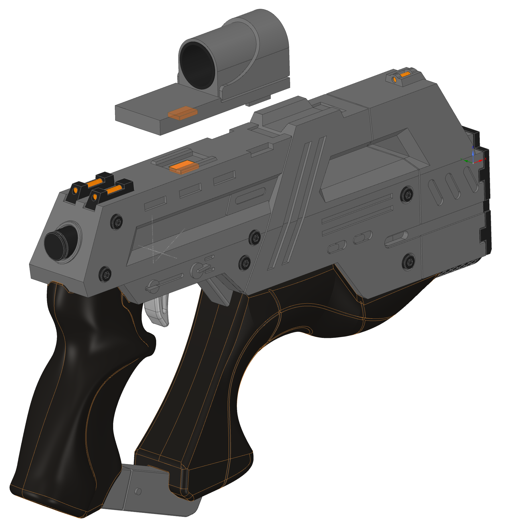

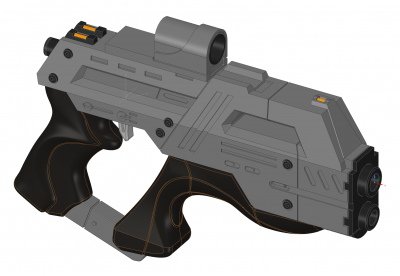

Here's my current design iteration:

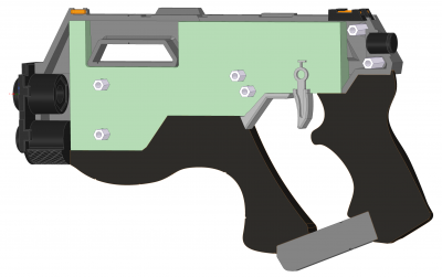

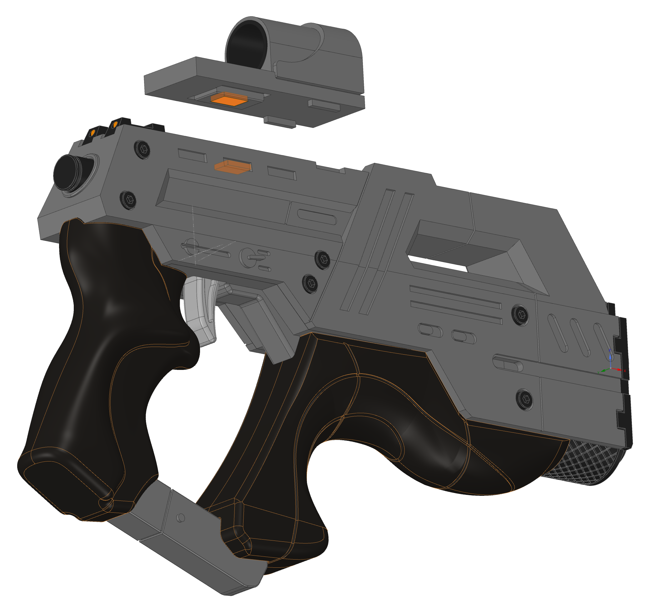

I made some improvements with the trigger guard: In the original design, the trigger guard (grey part) is thicker and doesn't really integrate with the pistol grip and front grip. I made it thinner and just slightly modified the grips so that the trigger guard actually integrates into them. Should improve the ergonomics, and of course it looks more like a true assembly than just a game model where these things don't really matter.
I will be using black M4 cylinder-head hex socket screws to assemble the pistol. Apart from the fact that you can disassemble the pistol again, these will look much better than 3D-printed fake screws.

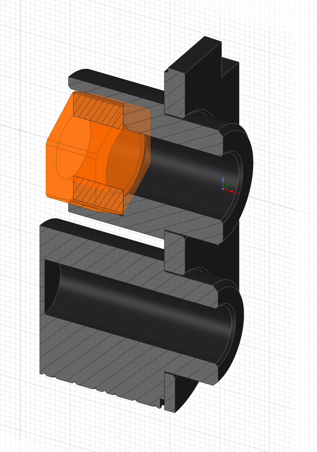

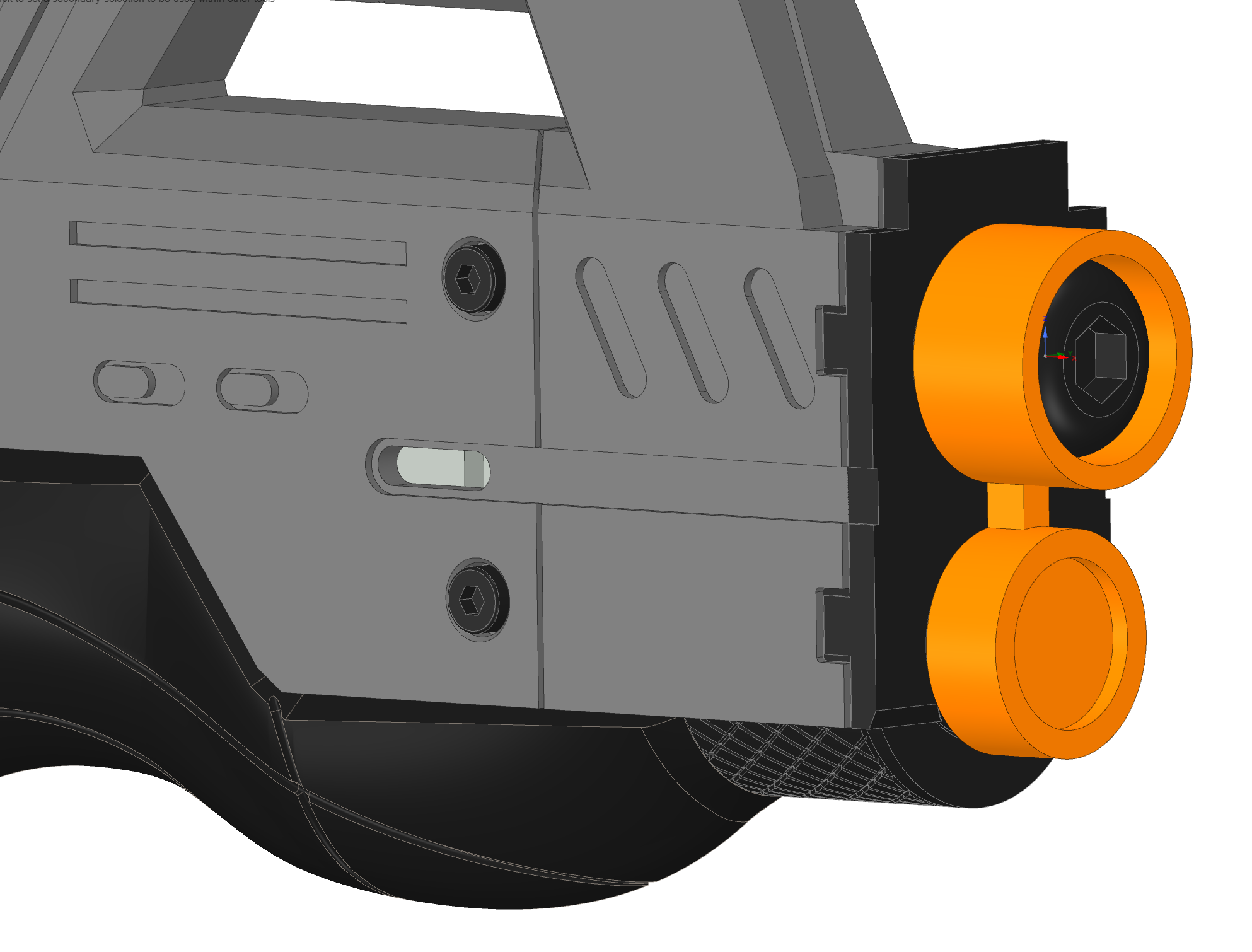

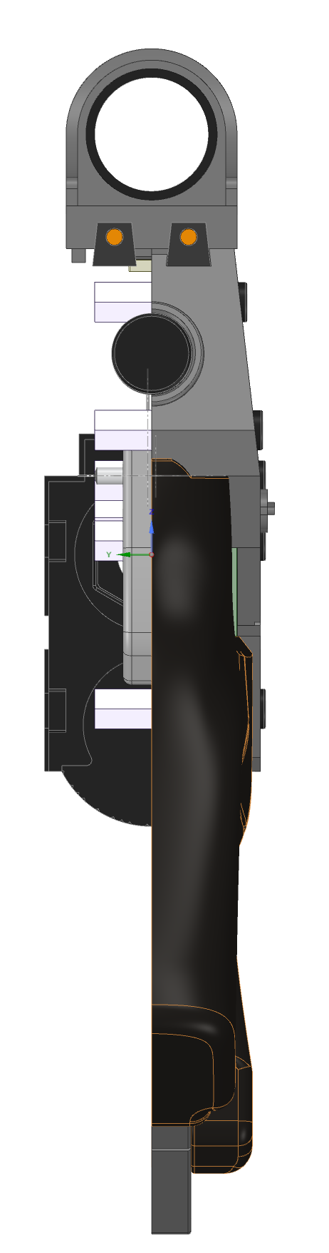

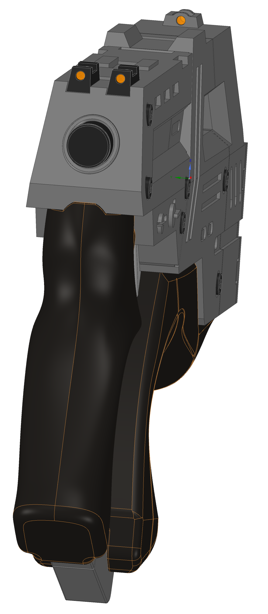

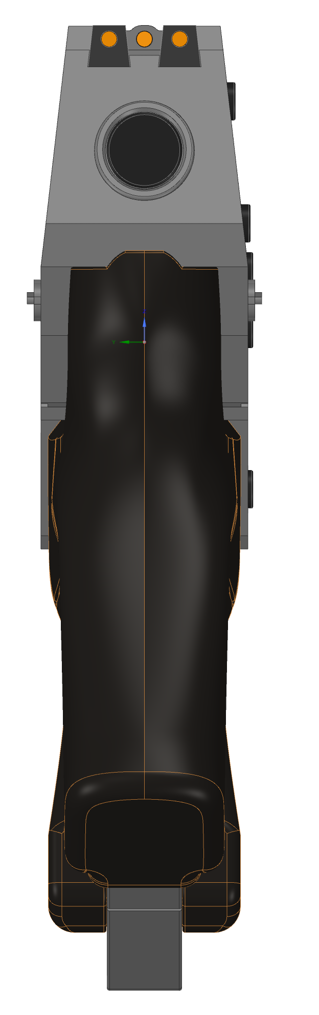

Last but not least (for now) the iron sights. I know - the original design doesn't really have any, but come on, a pistol without sights? I adopted what I call the "Trijicon-style" - Glow-tube sights which are open in the top to let in sunlight. At night, they glow (tritium), and in direct sunlight they are even brighter because the sun shines into the tubes. True genius... Yeah, it's just a mock-up with orange filament bits instead of tritium-tubes, but I want it to be related to some real concept in order to get it right.
Also modified some tidbits like the bolt catch pin which lacked some detail, and the front grip curve that didn't match the knurled lower barrel detail.

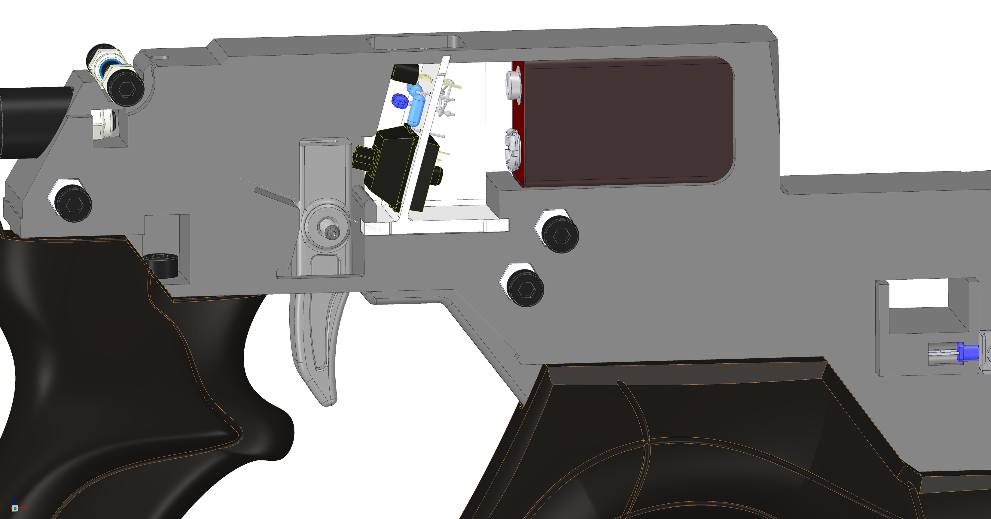

- Shelling and assembly (use screws, not glue for main parts)
- Add dummy weights for realism
- LED lights - trigger actuated

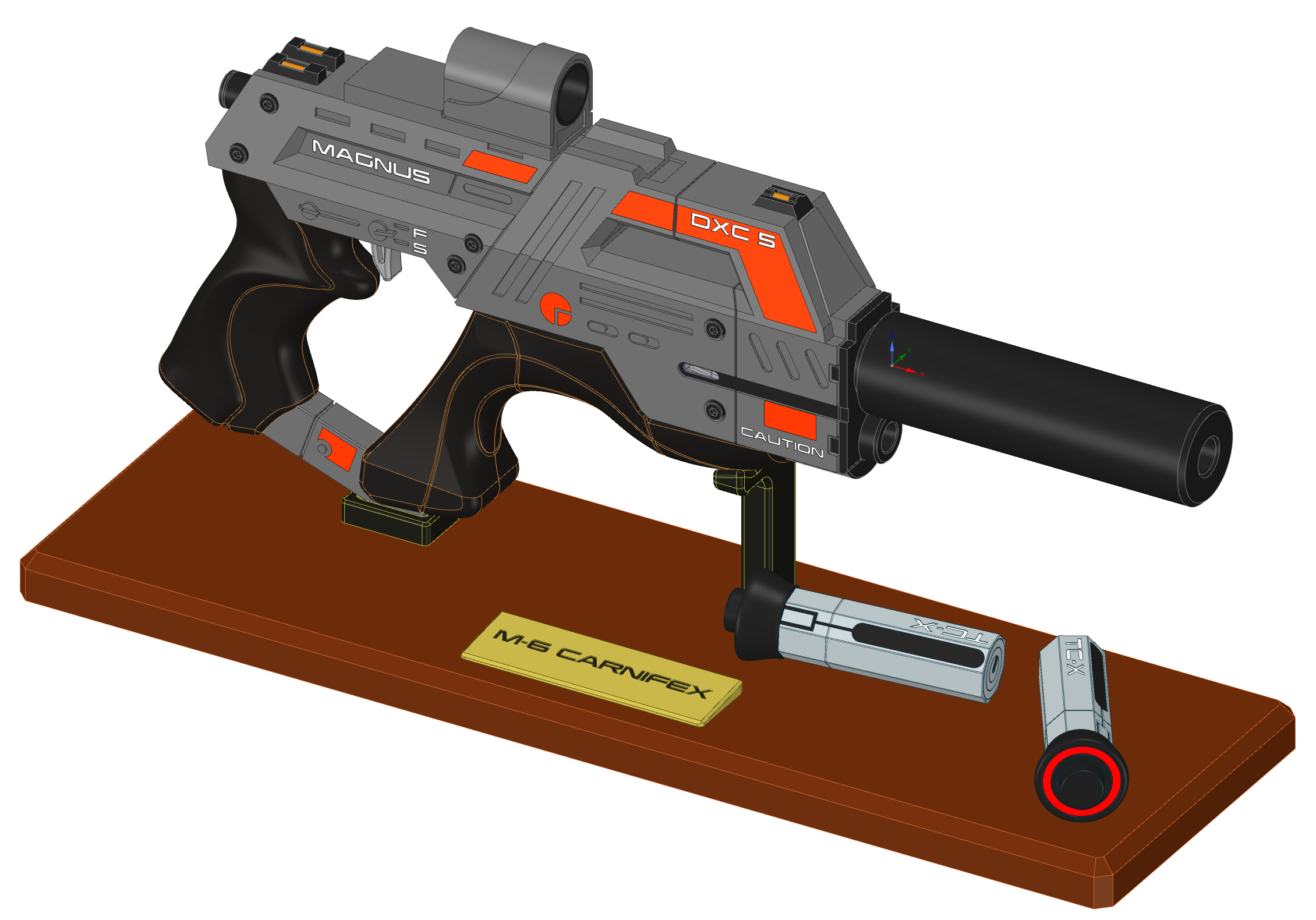

Thermal clips:

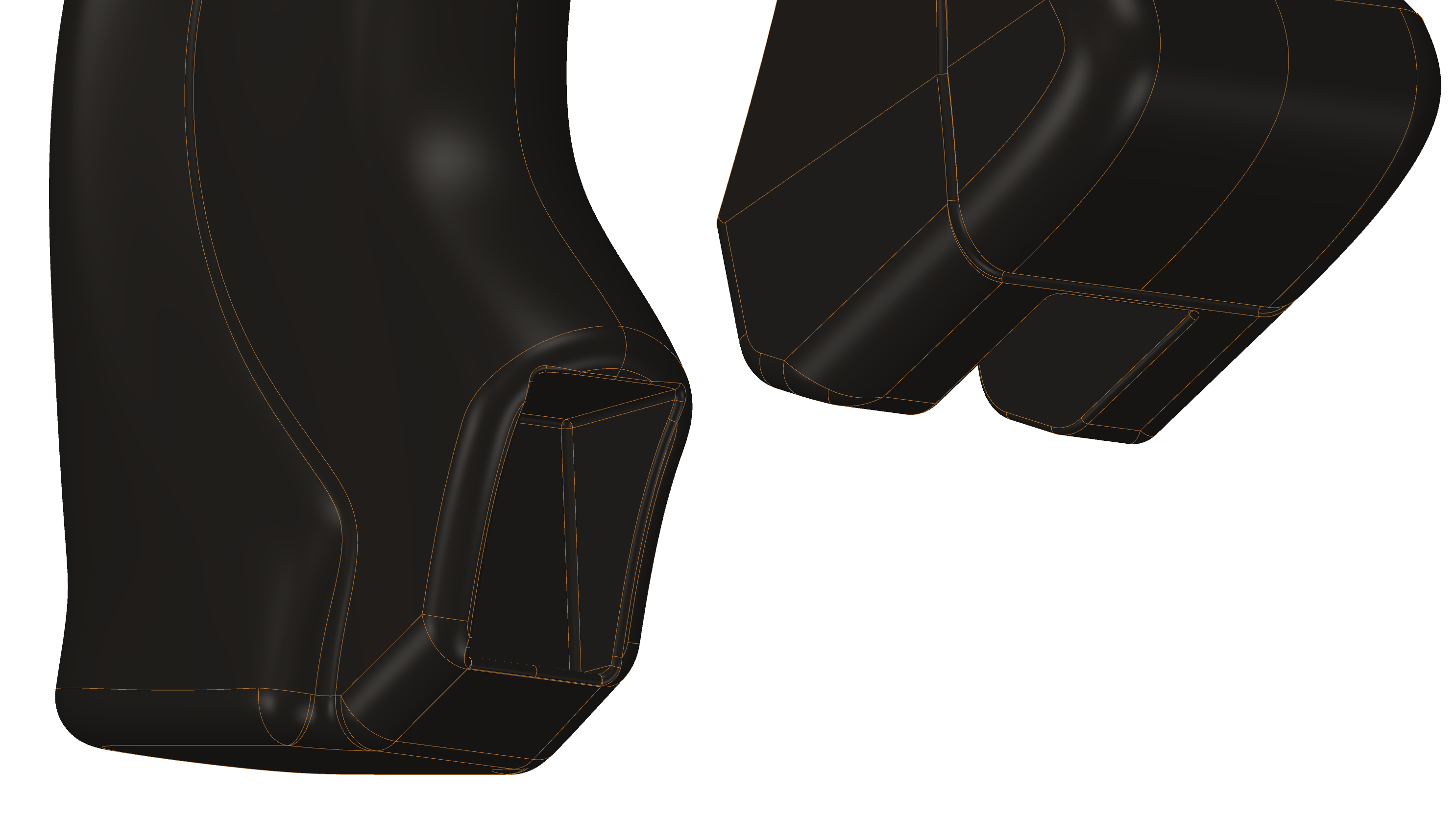

I couldn't figure out how or WHERE the thermal clips go into this thing. It seems like Bioware didn't take that into account when they designed the gun. I "could" adopt the lower barrel to actually be a thermal clip instead of a barrel, but that might deviate too much from the original design. Anyone got an idea where the clip is supposed to be?
There is definitely not enough space in the pistol grip where handguns usually store their clips.
