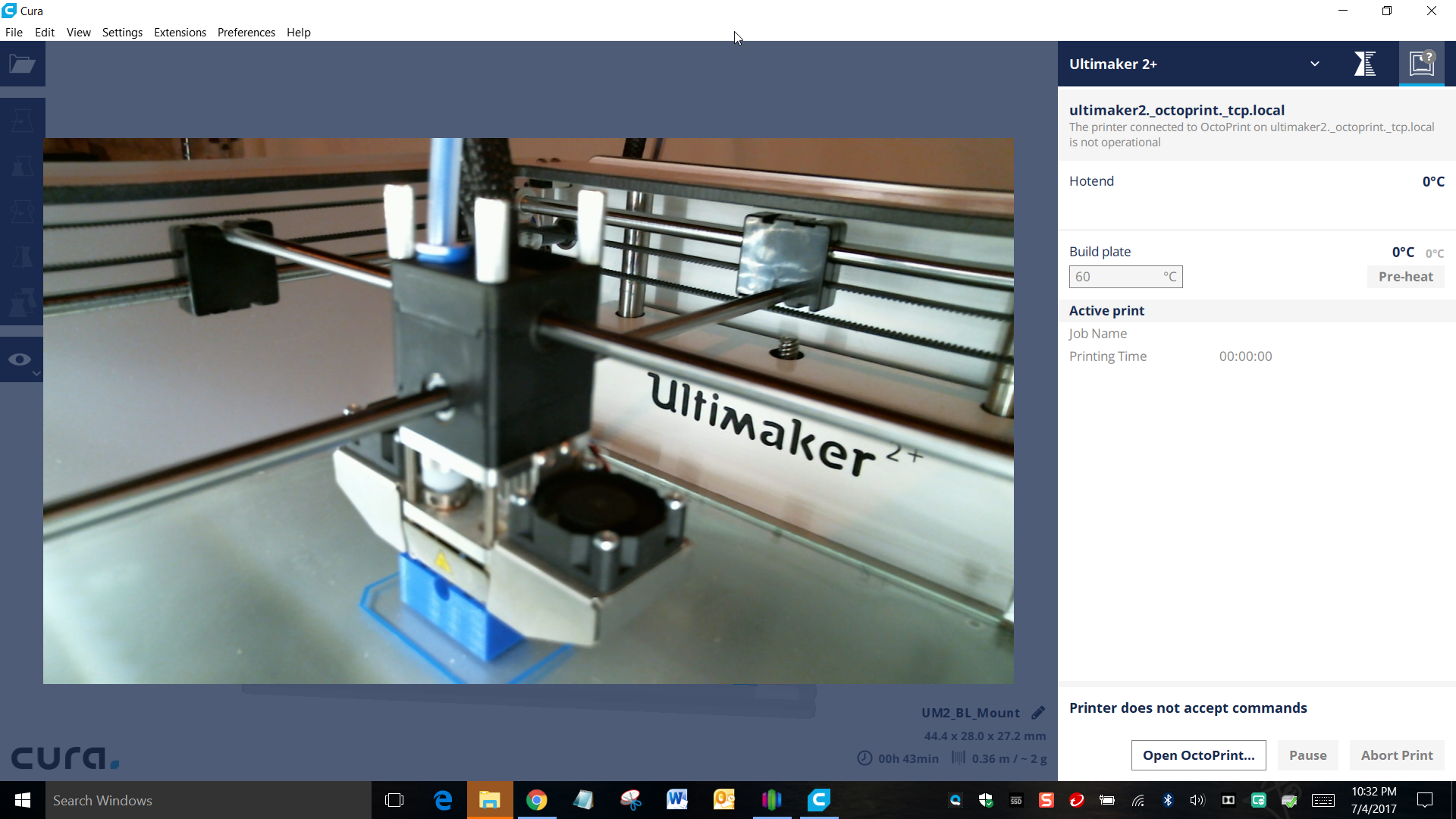

Found some instructions on how to make OctoPi work in Cura (because why would that be anywhere in the Cura release notes, right?)
In the sidebar, click on the name of your printer, and choose 'Manage Printers...' from the dropdown. Or open the Preferences window and navigate to the Printers pane. Once there, click on the 'Connect to OctoPrint' button.
In the window that pops up, with a bit of luck, you can select your OctoPrint instance. Before you press the Connect button, make sure you enter the API code. You can look this up in the OctoPrint webinterface (in the settings window)

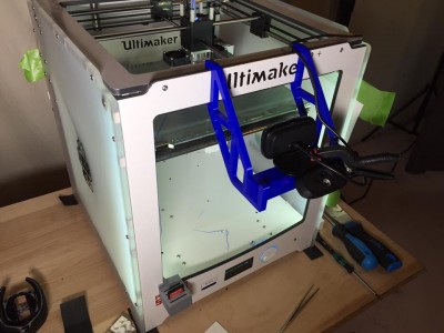

And got a nice view of my print in progress.

Well while the camera view works, and the option to Print with Octoprint, there's a few issues...
When print starts, it immediately raises the bed and print head temps, then when done, the bed is raised and print immediately starts.

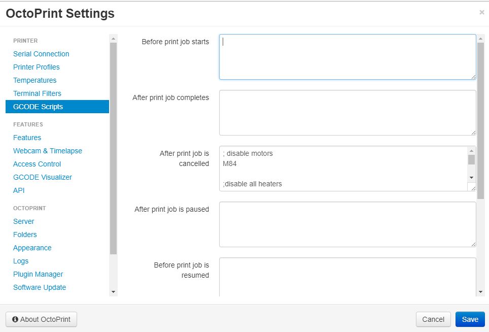

Re: OctoPrint and Cura
Octoprint uses reprap mode with a um2 start/end. Edit the sequence and test step by step sending the gcodes manually to detect the issue.

- Posts: 4060
Found something here: http://daniepstein.com/daniepstein/octo ... timaker-2/
Start and End Codes he suggests (again, from 2015)
