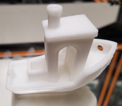

Wow. Went to Home Depot and bought a 6 pack of 12" mirrors (as seen on other forums). Swapped out the tempered glass with a single mirror, dialed it in for level, and prints are amazing. Printed Benchy, and it is the best one I have printed (better than my 3DP-17).
Still have some work to do (additional mods, Octopi, etc). Then I will use it to print the mods needed for my 3DP-17 to bring it up to par.
