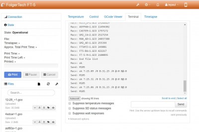

Am I correct, if I upgrade to Cura 2.X and above I loose Pronterface. More of the Option to send codes directly to the Printer.
If correct then can I regain this type control by using Octoprint.

To answer your first question, yes. Pronterface is gone in the newer Cura releases (but the other features are worth trying it).
I can't speak for Octoprint. Haven't tried it yet.

Re: Cura 2.X and above
I checked on my Octoprint for you...looks to be there!
