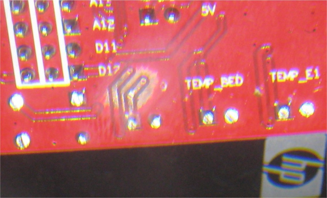

I replaced the Controller board with my Brand new Controller that I purchased just so I would not ever Be down.
I when I tried to Print my good old friend returned "MIN TEMP ERROR" started trouble shooting and every thing on the accessories tested Ok.
So started looking over the firmware nothing wrong there, it is working in the other machine.
Replaced the controller again so I could get a better look see.
And come to find that is has a faulty trace leading to the Hot End thermister. It was almost completely covered with the silkscreen,
looking carefully and all you could see was a little wave over the trace leading to the Hot end thermister connector.
While working in manufacturing as a quality control Electronics Technician, I recognized this instantly as a defective trace.
Using a Eurotool fiberglass cleaning brush erased the silkscreen from above the broken trace an bridged solder across the trace gap.
If I was still a QC Technician would a dabbed on a little silkscreen background color and returned to the assembly line.
Looking closely you can see that even the ground plane around the eaten trace has rough edges caused by the etching process.
No problems fixed now and already has Marlin 1.1.5 Firmware installed, so it's back to the replacement parts bin .
