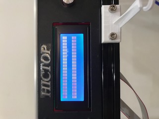

I found firmware referenced by shocksofmighty that I downloaded and compiled. My printer appears to be working now. What version of Marlin is this firmware?
I will try using this base fireware to add in my differential IR sensor and see how it turns out.

I see that you have not enabled the Display
This display has to be enabled to work the stock display for Hictop
//#define REPRAP_DISCOUNT_SMART_CONTROLLER

kgrigio
